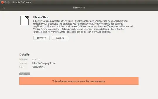

The latest LibreOffice is available in the Snap Store, you can either install it from Ubuntu Software (just search for "libreoffice") or just sudo snap install libreoffice.
This will still keep your older version of LibreOffice around, but you can remove those if you want:
