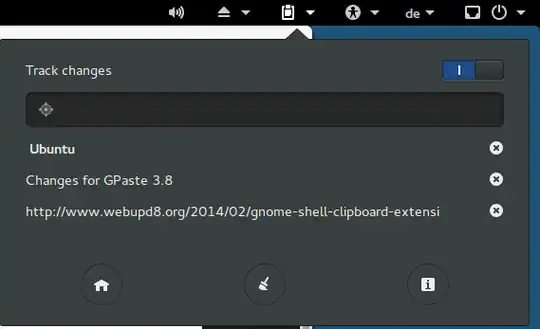

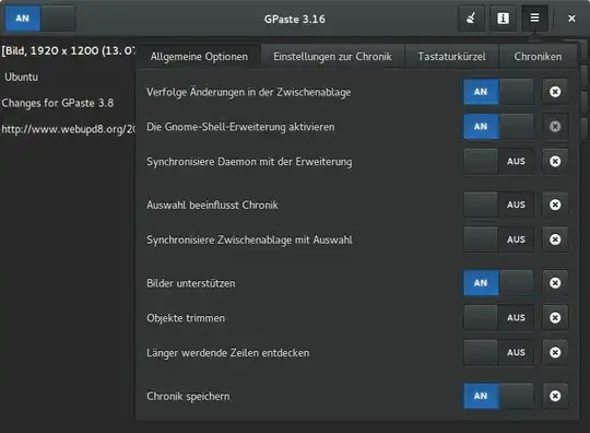

I'm using GPaste:
sudo add-apt-repository ppa:webupd8team/gnome3
sudo apt-get update
sudo apt-get install gnome-shell-extensions-gpaste
Sorry for the German screenshots

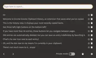

This seems to be the "canonical" recommend-clipboard-manager question (closed "duplicates": for 16.04/18.04, or with search function from 2022). A good option in 2024 has not yet been noted (so far as I can find) on askubuntu:
gnome-clipboard-history
gnome-clipboard-history is a Gnome extension rather than "independent" app. It's easily installed via the Gnome extension manager. It is nicely configurable, and includes a search function:
gnome-clipboard-history screenshot
Recently (I'm on 24.04 LTS) Diodon has been getting flakey on me: simply refusing to store clips, or paste them. I tried some of the other standard alternatives, and all proved to be glitchy. (I'm persevering with Wayland: is this a(nother) Wayland issue? Don't know.) But gnome-clipboard-history has proved to be robust and reliable.
