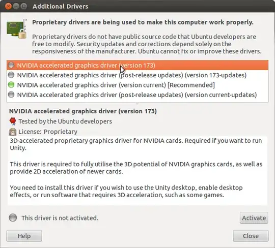

You shouldn't really need to worry about xorg.conf. You need to install your nvidia drivers. The first thing you need to do is login normally, hit SuperKey and type in: Additional DriversOpen the Additional Drivers. You should see the following:
Addtional Drivers Window
Select the one of your choice, and hit activate. The drivers should download for you, and install. Once the download/installation is complete, it will let you know that you will need to restart.

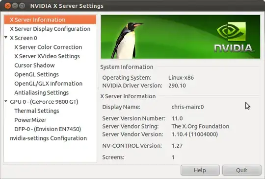

Once restarted you should then have access to the Nvidia X Server Settigns Application. You'll be able to find it by hitting SuperKey again and typing in: nvidia
Nvidia Xserver Settigns Application

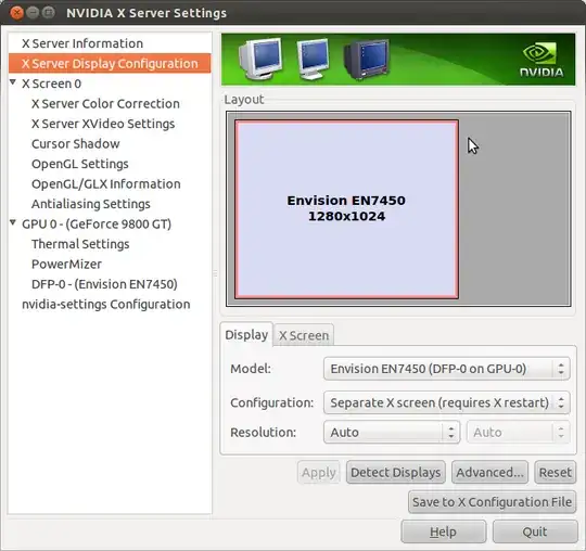

You can then go to:
Xserver display configuration option
Hit Detect Displays, Set the Resolution, and Twinview or with one of your displays (whichever you prefer) set to primary.
