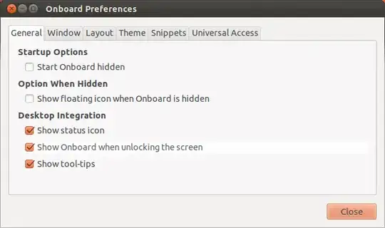

GUI method
Search for Onboard settings from the gnome-shell overview.
Under General tab and Desktop integration heading, uncheck the option Show Onboard when unlocking the screen.

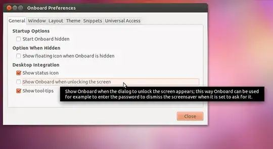

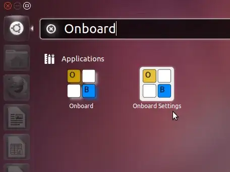

In the Dash, open Onboard Settings.
Unmark Show Onboard when unlocking the screen.
Done.
