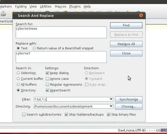

The stream editor,sed, is a powerful utility for this kind of work and is my first choice, however, if you want to do this from an ordinary text editor using an Ubuntu based native application, I would suggest you take a look at Jedit, It is available in the repositories and can be installed by typing in your console:
sudo apt-get install jedit
Start jedit, click the search menu item, in the menu list, click the Search in Directory item, you will be presented with the dialog below:
Jedit Search In Folder Dialog
This is similar to that of Notepad++ and does the same thing, I believe this is what you want.

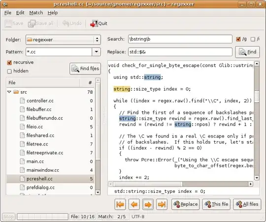

Another GUI option is regexxer: regexxer screenshot
