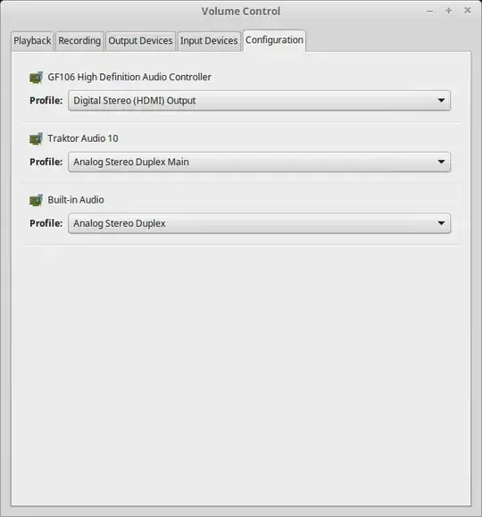

I'm trying to use my Traktor Audio Interface as standard output device. Under Windows this is really simple but so far I couldn't get it working.
My first try was to use this alsa config and to define it as default like this:
pcm.!default {
   type plug
   slave.pcm T10_pair1
ctl.!default { type plug slave.pcm T10_pair1 }
I can use it by specifying the audio device but my default clause seems to have no effect.
mpg123 -a T10_pair1 ./sound.mp3 # this plays via Traktor Audio
mpg123 -a default ./sound.mp3 # this still plays via my onboard sound card
PulseAudio detects the Traktor Audio 10 but doesn't let me choose it as output device.
pavucontrol Configuration pavucontrol Output Devices
list-cards output
list-sinks output
fap
  • 133
I've the exact same problem. Use the following shell command :
pactl load-module module-detect
Then your device should appear in the output list.
