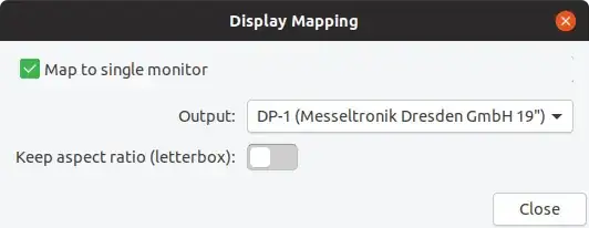

As of 18.10 this can be configured in the Ubuntu Settings.

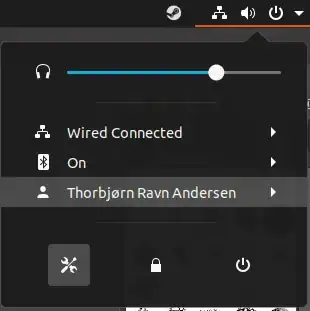

Open Settings through the upper right menu:

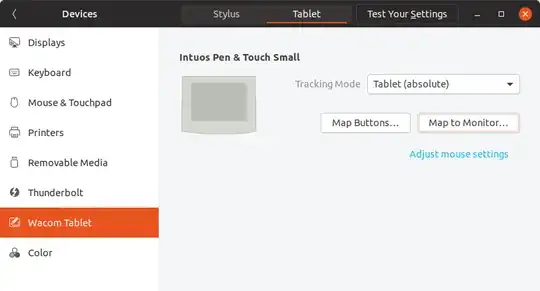

and go to "Devices". Chose the "Wacom Tablet" entry in the left column and choose the "Table" button in the top row.
wacom tablet devices entry
Check the "Map to single monitor" checkbox and select the monitor you want to use in the drop down box. Here I have a 19" monitor connected with DisplayPort.
display mapping dialog box

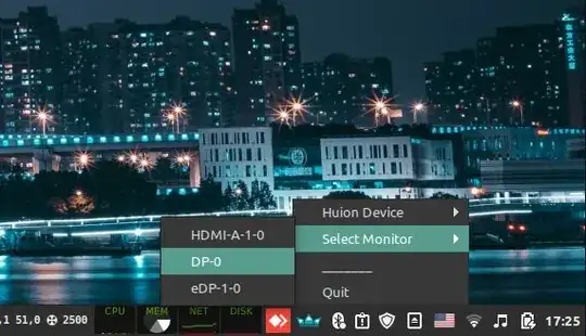

Based on the answers given here I have developed a Linux system tray app (in python 3) that allows to select the output monitor from the available monitors.
screenshot
