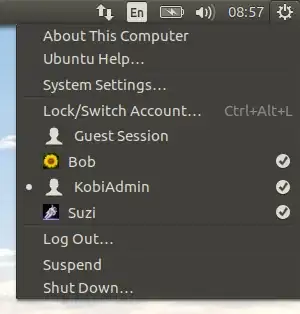

Fast user switching is a deal breaker for me on most of the desktop environments. In Unity it is best - you always have a menu with all users, and you can switch with a single click (assuming no passwords):
Unity user switching
