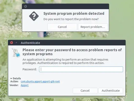

  • I see an error message: System program problem detected

I think this is related because sometimes after switching users I see the error message, and sometimes hear the error message sound.
