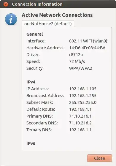

Lastly, this is the connection information:

When I ping my router, ping -c3 192.168.1.1, I get 100% packet loss. When I ping my computer next to me ping -c3 192.168.1.106 I also get 100% packet loss (I didn't know I could ping myself at 192.168.1.106 which was successful, though I don't think that's very notable).

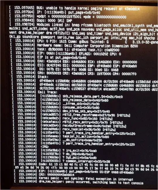

I shutdown the Windows OS and restarted in Ubuntu to see if I unplugged the wireless adapter and plugged it back in if I would get the same results as I saw in Windows. When I plugged it back in, it that the connection had been established but then my screen flashed and it went to a black screen with white words (kind of like the terminal or command prompt). The last two lines stated:
Kernel panic - not syncing: Fatal excepption in interrupt
drm_kms_helper: panic occured, switching back to text console
Actually, here is the screen I get:
From here my Caps Lock and Scroll Lock keys blink together on my keyboard and I can't do anything except to turn off the computer.
