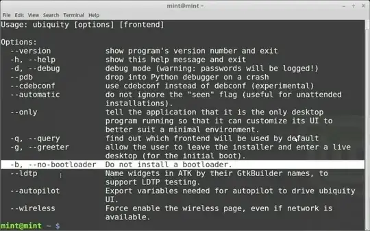

I know on Linux Mint 18.3 Cinnamon, which is based on Ubuntu 16.04, the following command works:
ubiquity --no-bootloader
This apparently is an alias for the option -b and is known to work on Linux Mint 18.3 Cinnamon.
I have not verified that the --no-bootloader tag works on ubiquity in vanilla Ubuntu 16.04 (and later versions). Perhaps someone running Ubuntu 16.04 (or whatever version) can check and comment here with their version number and whether the command ubiquity --no-bootloader command works? If it works, after authenticating using the GUI authenticator, Ubiquity will load. If it doesn't work, after authenticating using the GUI authenticator, you will kick back to the terminal and an error message will print saying ubiquity: error: no such option: [...].
Screenshot of ubiquity options in Linux Mint 18.3 Cinnamon:
ubiquity options printout from terminal on Linux Mint 18.3 Cinnamon

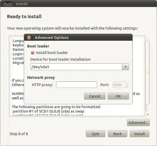

In the past, Ubuntu had an advanced option that allows user to customize boot loader installation. Between Ubuntu LTS releases, the advanced option was last seen in Lucid Lynx (10.04) release. The option had been removed since then, for any reason that I didn't follow up.
Old screenshot as proof:
Step 8/8 of Ubiquity installer in Ubuntu Lucid
Install on same partition
In particular step, one can just select device other than the primary device /dev/sda for boot loader installation. For example, Ubuntu will be installed on /dev/sda4 partition, so boot loader shall be installed on /dev/sda4 also.
By doing so, user will have:
  • new boot loader at /dev/sda4 that will be hidden, unless the machine is boot with option to chainload to the partition to reveal it
  • existing boot loader at /dev/sda will handle detection of newly installed operating system at /dev/sda4, without having to rely on the new boot loader
  • user will need to update boot loader at /dev/sda from the first installed operating system, in order to detect subsequently installed systems at other partitions
Unless there is any critical reason for not dealing with boot loader at all, I don't see any side effect of installing subsequent boot loaders to respective partitions.
