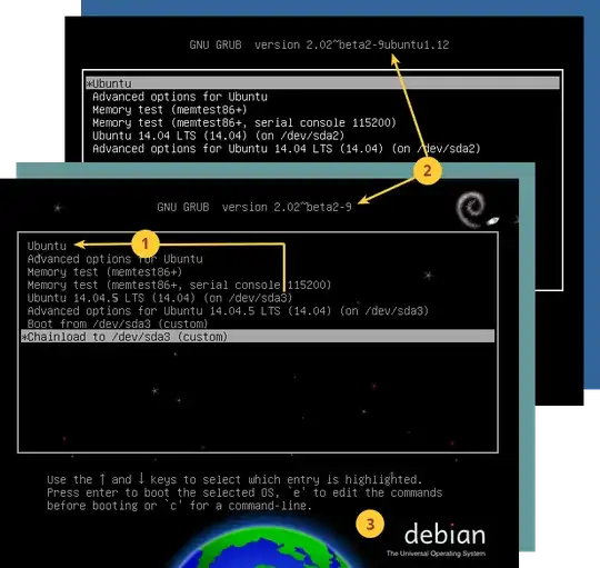

To know from which partition the user had booted, look at the boot loader menu before booting any of the installed systems. It's difficult to tell without seeing the boot loader menu.
Where to look at
In the following combined screenshots, I have labeled three hints that one might know from which partition the user had booted.
Multi boot menu using GNU GRUB PC/BIOS version with annotation
Label (1): GNU GRUB menu entries below the first entry
Label (2): GNU GRUB version at top of boot loader menu
Label (3): GNU GRUB background image (manual setup required)
The most apparent hint is label (3), which is to change GNU GRUB background image on the system that have control of boot loader menu. It is the easiest to tell, provided user set it up beforehand.
Label (1) explained
Look for partition that is not listed in menu entries below the first entry. In the screenshot, there are only two operating systems being installed i.e. "Ubuntu" and "Ubuntu 14.04.5 LTS".
Ubuntu
Advanced options for Ubuntu
Memory test (memtest86+)
Memory test (memtest86+, serial console 115200)
Ubuntu 14.04.5 LTS (14.04) (on /dev/sda3)
Advanced options for Ubuntu 14.04.5 LTS (14.04) (on /dev/sda3)
The latter has mentioned (on /dev/sda3), which means the former might be located on /dev/sda2 or /dev/sda1. To be sure, after booting the system i.e. "Ubuntu", run relevant command to list down available partitions (lsblk seems to be most straightforward).
$ lsblk
NAME   MAJ:MIN RM   SIZE RO TYPE MOUNTPOINT
sda      8:0    0    13G  0 disk
├─sda1   8:1    0   976M  0 part [SWAP]
├─sda2   8:2    0     6G  0 part /
└─sda3   8:3    0     6G  0 part
sr0     11:0    1  55.7M  0 rom
Only after comparing to the output of lsblk, then we know that the system i.e. "Ubuntu" is found at /dev/sda2 (which was not listed in menu entries) from which boot loader menu is managed.
Label (2) explained
Look for GRUB version that is printed at top of boot loader menu. Note that version and compare to the GRUB version that is found on the booted system i.e. "Ubuntu".
In the screenshot (bottom half): GNU GRUB version 2.02~beta2-9
After booting the system i.e. "Ubuntu", run relevant command to check the version of GRUB package (grub-install --version is relevant and most straightforward).
$ grub-install --version
grub-install (GRUB) 2.02~beta2-9
How is this relevant? Because grub-install and update-grub commands are both provided by the same package grub2-common. Given that the boot loader menu is created and updated using tools from the same package, the printed version at top of boot loader menu will be the same.
Label (3) explained
This hint requires to be set up manually, since the default background image of boot loader menu is none (just plain black). The background image must be 8-bit depth.
If desktop-base package is installed on your system, such background images that are made specially for GRUB are readily found with file name suffix *grub.png in the target directory.

Disclaimer
This answer explains for proven and well tested criteria for BIOS system with multi boot setup using GNU GRUB PC/BIOS version. The following exceptions will apply.
  • For UEFI system counterpart using GNU GRUB EFI version, it is not guaranteed or not known if the criteria would appear to be the same as described above.
  • Emphasis is given to the looks of boot loader menu (how it may appear different i.e. top half of screenshot) rather than to demonstrate how the chainloading works. As such, regarding "how multi boot was set up as seen in the screenshot" would not be explained in this answer.
  • If multi boot setup is ever made of exactly same copies of similar operating system i.e. Ubuntu 14.04, Kubuntu 14.04, Xubuntu 14.04, etc., then the only reliable way to know from which partition the user had booted is label (3).
  • Label (3) might work better using custom background image that explicitly writes from which it is booted i.e. "This boot menu is managed from /dev/sda1". Similarly, regarding "how to create custom background image for GRUB" would not be explained in this answer.
TL;DR Look at the boot loader menu before booting any of the installed systems. The easiest and most reliable way to know is label (3), which is to set up GRUB background image manually.
