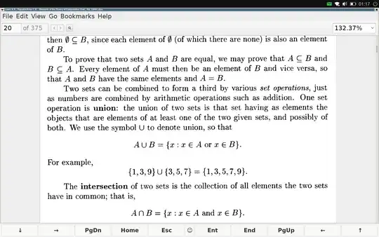

Let me combine comments and some piece of info from Internet and write answer. Matchbox-keyboard configuration is buggy, but it was possible to create a suitable config file only with arrows, some navigation keys and small height. Example of configuration see there. Place it in file
~/.cache/libertine-container/my-container/rootfs/home/phablet/.matchbox/keyboard.xml
Screenshot of usage:
At first we should start app (like Evince or Firfox), where we want to use navigation arrows. After that we should run matchbox-keyboard from terminal as Bjarne described:
DISPLAY=:0.0 libertine-container-manager exec -c "matchbox-keyboard" --id my-container
Right now I don't know how to create single launch file (.desktop) to run the matchbox-keyboard. And only one window with matchbox-keyboard is supported now.
