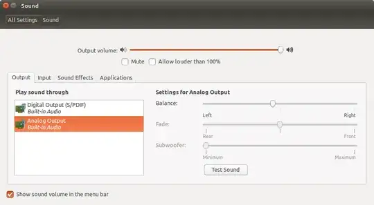

I know this isn't the answer you want, but testing indicates that simply the act of plugging a pair of headphones into the headphone jack eliminates any output to the speaker jack. You can test this for yourself via the sound app as shown below. Run it, unplug your headphones and you will see this:
sound-no-headphones
Use the Test sound button to confirm that you are getting output out of your speakers.

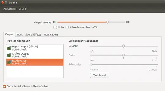

Then plug in your headphones. You will see them show up automatically highlighted as seen below:
sound-headphones
If you now highlight The previously selected output (In my case Analog Output) And repeat the Test Sound process you will get nothing from the speakers as the act of plugging in the headphones changes the route at the hardware level. This is commonly done with a switch contact connector that looks like this internally.

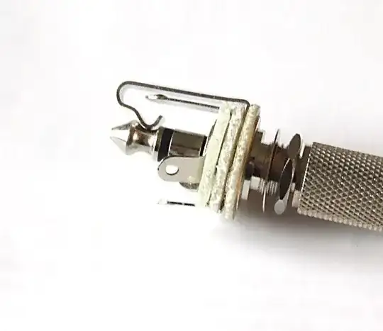

As soon as you plug into the jack, the 'spring loaded' connectors in the jack are both connected to the male plug, and disconnected internally from the speakers.
In order to have any chance of doing this whatsoever you would likely have to swap out or modify the headphone jack to insure that the signal doesn't get interrupted to the speakers upon insertion. I am NOT recommending this course of action and will NOT be held responsible for any damage you manage to inflict on your system in the attempt.
Then you would have to utilize the find command to determine what file changed in the seconds it took you to change the output in the sound app and analyze the changes for clues as to how to duplicate them via the CLI. This part is untested and a total assumption on my part based on information at hand.
