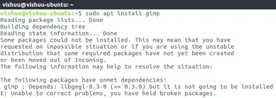

I am trying to install GIMP through the terminal.. But The following error is showing..
The following packages have unmet dependencies:
 gimp : Depends: libgegl-0.3-0 (>= 0.3.0) but it is not going to be installed
E: Unable to correct problems, you have held broken packages.
Help is appreciated.

Run the following commands to clear out the package cache, resolve dependencies, and (hopefully) fix install issues:
sudo apt update
sudo apt -f install
sudo apt full-upgrade
sudo apt install gimp
Breaking this down a bit more:
  • sudo apt update
    This command will download new package caches and package data from the Ubuntu servers.
  • sudo apt -f install
    This command, known as "fix all the problems" will attempt to smartly resolve any dependency issues, and re-install any broken packages. In your case, it will likely re-install the missing GEGL library.
  • sudo apt full-upgrade
    This command runs a full upgrade of all of your software to bring you up to the latest version. Note that it does not change your OS version, so it won't upgrade 14.04 to 16.04.
  • sudo apt install gimp
    This command installs gimp, as one can guess.
Kaz Wolfe
  • 34,680
For me the above answer didn't fix the problem. Apparently due to a dependency error with libgegl-0.4-0 gimp can't be installed.
sudo apt install ppa-purge && sudo ppa-purge ppa:otto-kesselgulasch/gimp
This line fixes this problem. Found here: Upgrade libgegl-0.4-0
