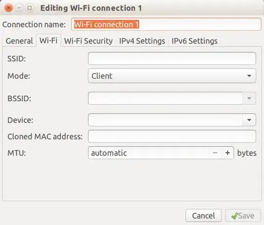

The easy way to do this is to use the GUI provided by Network Manager.
Go to the network icon in the top panel, choose Edit Connections, locate the wireless connection profile for the desired SSID, open for EDIT, and go to the BSSID field and either 1)pop up the desired BSSID, or 2)manually enter the desired BSSID.
See below for an example wireless connection showing its BSSID field.
