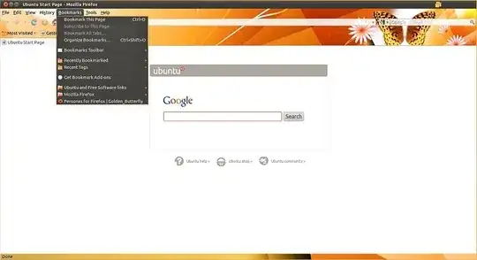

Before
Before

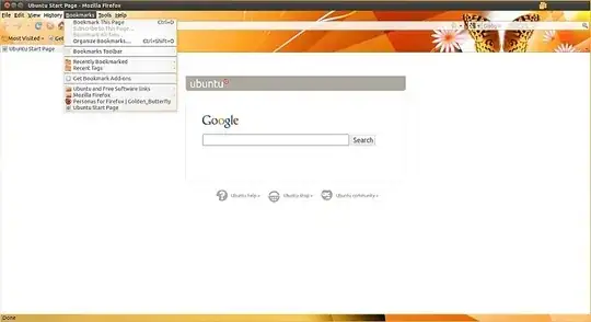

After
After

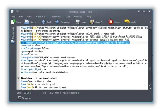

I would like to add to the great answer of @lovinglinux a way to make Firefox to load the theme when opened from a launcher in the taskbar instead of command line:
  1. Copy the Firefox desktop file to your home directory.
    mkdir -p "/home/$USER/.local/share/applications/"
    cp -v "/usr/share/applications/firefox.desktop" \
  2. In the Exec line, replace the value after = with a command using the instructions provided by the mentioned @lovinglinux:
    bash -c 'GTK2_RC_FILES=/usr/share/themes/Redmond/gtk-2.0/gtkrc firefox %u'
Kate editing firefox.desktop

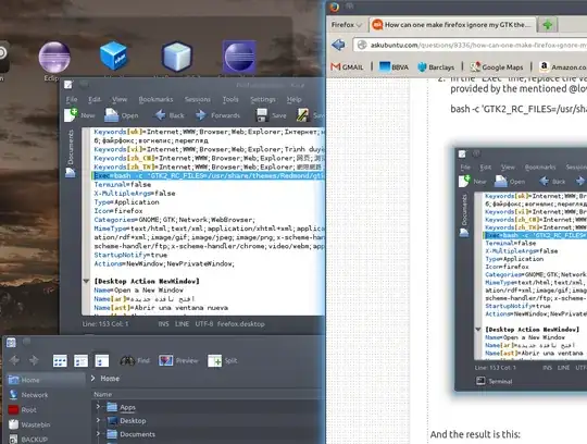

And the result is this:
Firefox with Redmond theme and all other applications with a dark theme
