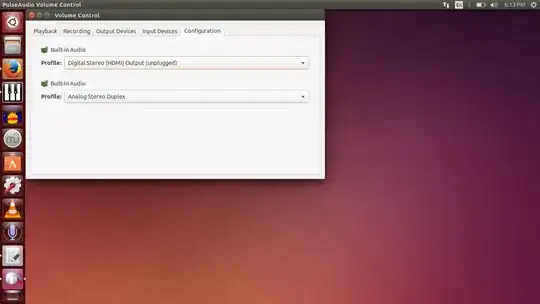

before installing PulseAudio? If not, do it. The audio functions too need essential libraries and compilers at time. Now I know this is basic, but perhaps, it may have been overlooked. It had happened to me a couple of days ago.
So next, check this:
  1. Go to the dash on the top-left corner of your screen
  2. Type in pulseaudio and open the pulseaudio volume control
  3. Open an mp3 file and let it play while you check these two tabs. Check the options available one-by-one and select the one which allows you to listen to the mp3 file being played. Output devices Configuration
  4. If/when you will have been successful in fixing your problem, go brew yourself a warm latte.
