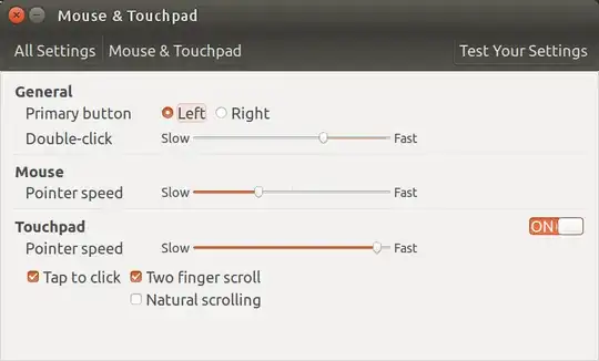

Although I use a wireless mouse, I also upgraded from 14.04 to 16.04 on a Dell Inspiron 17R 7720 SE and the two finger scrolling works perfectly (I just tried it). I'm on Kernel version 4.7.5 with Intel microcode updates though and never tested under Kernel 4.4. I just want to let you know it does work on Dell touchpad under 16.04.
There is a screen you need to go to in System Settings, Mouse & Touchpad to enable two-finger scrolling as this screen snapshot illustrates:
Two Finger Scrolling
Edit 1 - Synaptics Driver Override
Having verified that Two finger scroll is checked and it still doesn't work, we need to dig deeper. Read wiki.debian.org/SynapticsTouchpad. Where it says:
If multitouch doesn't work for you, your hardware may not support it, but you can use the following options to emulate multitouch which allows most of the features to work. Try adding these lines to the Touchpad section:
Option          "EmulateTwoFingerMinZ"  "35"
Option          "EmulateTwoFingerMinW"  "8"
Follow the instructions in the link
