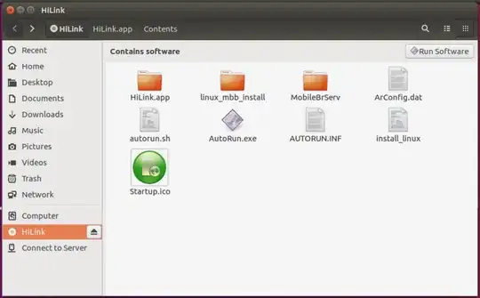

Edit 1 - New Information from OP
Here is a screenshot of USB files:
USB Startup

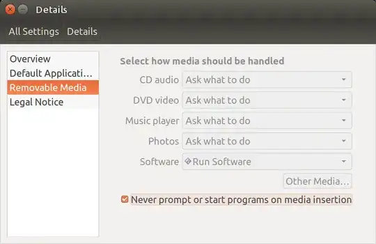

In order to disable auto-run of the USB (generating the error message) go to System Settings, Details, Removable Media and check the last box to never auto-run inserted media:
Removable Media
This should make the error message go away when the USB is inserted.
