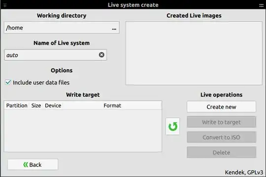

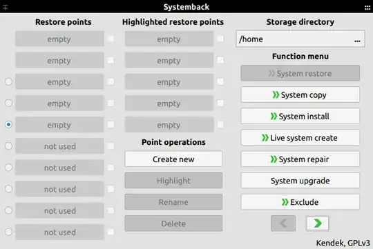

One can backup and make live iso files with Systemback utility, you can install it from its PPA and it works the same as remastersys (no longer maintained), i think. ubuntu 14.04 needs an extra package called unionfs-fuse too. It can also create live usb images. You can add your user files in iso which can then be installed on other machines, but other machines may have different graphics etc so make sure you have not uninstalled preinstalled xorg video packages. So all you need is add ppa and install
sudo add-apt-repository ppa:nemh/systemback
sudo apt-get update && sudo apt-get install systemback unionfs-fuse
After creating iso file, creating live usb and booting from it on same machine or different machine, you will find systemback installed.
enter image description here Systemback
