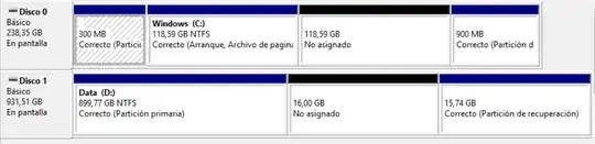

I want to install Ubuntu having a dual boot. I have reserved space for it:
Disk space
Disco 0 is my ssd, and disco 1 the hd.
