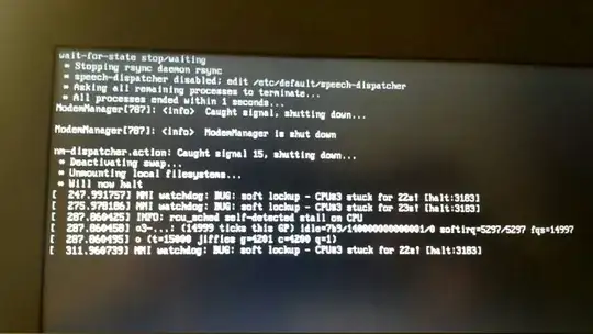

I have this output. It freezes in # Will now halt, but it doesn't.
Sys log
Sorry for bad quality.
I have been experiencing the same incomplete shutdown:
Will now halt
reboot: System halted
After trying all sorts of suggestions, I have commented out the following line in /etc/default/grub, run update-grub and everything returned back to normality:
GRUB_CMDLINE_LINUX="acpi=off noapic nolapic nomodeset"
I have no idea how and why it has surfaced there in the first place though.

Add the command acpi=off to your grub boot. That may or may not work.
As an FYI, this is an acpi error- the "Will now halt", and then the corresponding freeze, means that your computer has completely shut off the CPU and other components. You can safely shut the power down- holding the power button shouldn't result in power loss.
TL;DR- It's perfectly fine to shut down the computer by holding the power button
Also, consider upgrading to 16.04.
