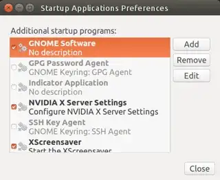

The next step is to select Dash which is the first option on the Launcher. In the search field type in Startup and select the icon Startup Applications. The following window pops up:

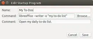

Select the Add button. And this window appears:
Fill in your writer / program name and pass it the name of your to-do file. This is probably the hardest part to get right and often requires a little experimentation.

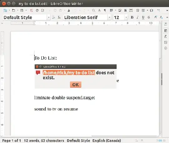

Proving that experimentation is needed when using the above example tonight an error was displayed:
ToDo does not exist
Checking the actual file name ends in .odt edit the Startup Application profile and change the file name by adding the extension .odt and then voila on every boot you get:
ToDo List
