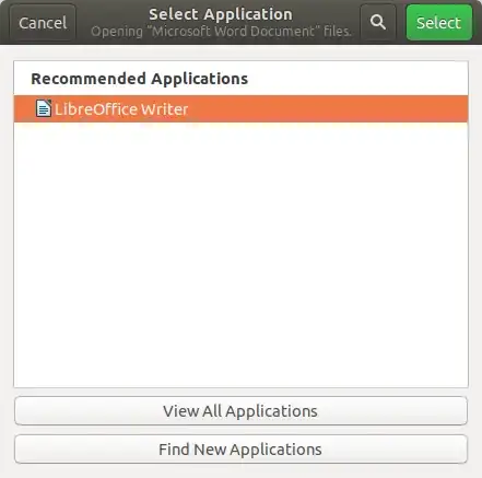

While browsing files in nautilus, I want to open a tex file with Kile. But, when I get to a dialog similar to the screenshot below, I do not see Kile. Yet, I see it in the "Open With" menu.
How do I fix this?

In GNOME3 when apps that show on the right click Open With Other Application context menu but not on the right click Properties menu do so because the Exec= line in the apps .desktop doesn't end with a %letter
That's the case with Kile. The 2 most likely letters would be f or U, I'd try U first.
gksudo gedit /usr/share/applications/kde4/kile.desktop
Make the Exec= line look like this
Exec=kile %U
Should then show (do a log out/in if needed)
