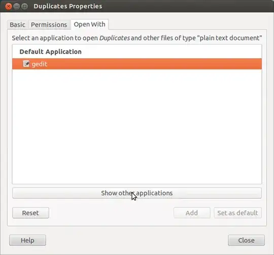

They are grayed out because the default program is selected.

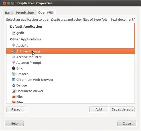

Just click on any other program and the buttons will be clickable again.
How to set the default application for a particular file type in 12.04.
Using the file manager (Nautilus) navigate to a file of the required type. Right click it and select "Properties". Then go to the "Open with" tab and make your selection.
