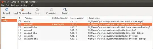

Below is a screenshot of the 'pinned' older version of Conky on Xenial, seen in my old friend Synaptic, the exclamation mark signifying that the package is 'pinned':
