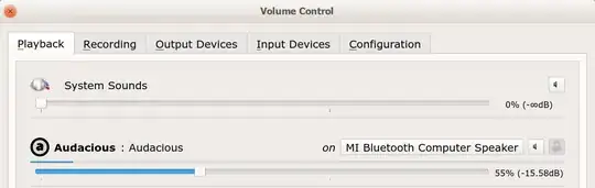

This is old, but I had the same problem on 18.04 and none of the solutions offered worked for me.
What worked for me, at least for Audacious, was to start PulseAudio Volume Control, and after I started Audacious - I selected Mi Bluetooth Computer Speaker from the dropdown.
PulseAudio Volume Control Playback tab
