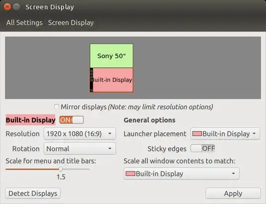

My monitors are only 1920x1080: a 17" laptop and a 50" TV. The smaller laptop sits four feet away and I need to increase the size of everything to see it better.
Go into System Settings -> Screen Display
On the Scale for menus and title bar, I set to 1.5 on 17" Laptop screen but leave at 1.0 for TV. I'm not sure if this will work for you...
