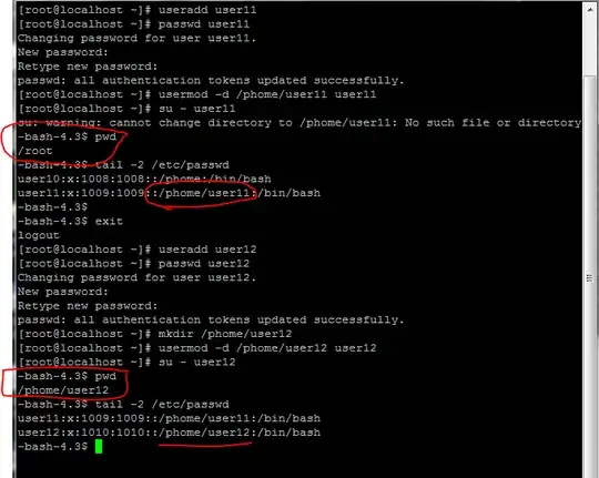

I created user 'user11' in Linux and changed its home directory using the -d option but when I login with this user, it shows '-bash-4.3$'.
user mod -d screen shot
I want to know:
  1. What is the meaning of '-bash-4.3' and why does it happen?
  2. Why user11 prints its working directory '/root' and user12 prints '/phome/user12'?
  3. How can I change '-bash-4.3' to it's usual meaning (as user11 or user12)?

You've tagged your question adduser but you seem to actually be using useradd: AFAIK useradd (unlike adduser) doesn't copy the skeleton files from the /etc/skel directory - in particular, it doesn't create a default ~/.bashrc for the new user.
To answer your questions point-by-point:
  1. it is the default bash shell prompt, used in the absence of a more customized one that is usually provided by the user's ~/.bashrc file
  2. because you didn't create the home directory for user11 (and neither useradd nor usermod -d do that for you)
  3. either copy the default .profile and .bashrc files from /etc/skel into the users' home directories, or delete the user(s) and start over using adduser instead
See What is the difference between adduser and useradd?

Addressing each of your points in turn:
  1. -bash-4.3 is the default prompt for you shell, which is bash. It shows the shell and its version.. The prompt is set by the environment variable PS1. See Bash/Prompt customization.
  2. user11 has a different value of $PS1 to user12. You can verify this by typing echo $PS1 for each user.
  3. In ~/.bashrc, for user12, add the line:
    export PS1="${PWD}> "

Concering your questions...
  1. What is the meaning of '-bash-4.3' and why the it happens?
It is the shell used and its version.
  1. why user11 prints it's working directory '/root' and user12 prints '/phome/user12'?
Because user11 does not have a home directory ( /phome/user11 ) in the filesystem.
  1. how can i change '-bash-4.3' to it's usual meaning (as user11 or user12)?
Create a home directory /phome/user11 as specified from getent.
What you have done is that you only have altered the information where to find the user homedirectory, but you did not create one.
Creating a new home directory for user11
cp -a /etc/skel /phome/user11
chown -R user11:1009 /phome/user11
Best would be to use useradd ... -m to create the user homedirectory automatically.
