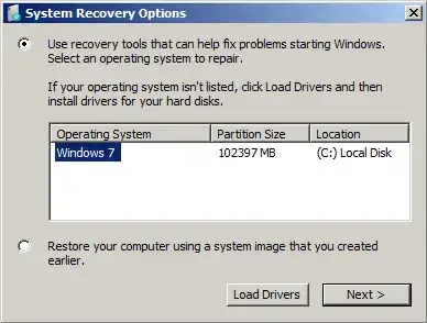

I installed Ubuntu on my laptop and something happened and my Windows 7 bootloader is missing. I can boot only Ubuntu. So, I tried to do something like suggested here How to restore Windows 7 loader or here, but when I see system recovery option there is no Windows 7 option.

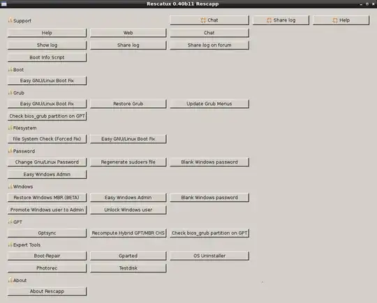

Rescatux
Rescatux is a free bootable live CD/USB that can repair GRUB and the Windows bootloader. Rescatux has a graphical interface with a menu of operating system rescue tasks. If your hard disk has the MBR partitioning format, you can select the Restore Windows MBR (BETA) option to repair the Windows bootloader. If your computer has UEFI firmware, you can select among the UEFI boot options.

Rescapp is a nice wizard that will guide you through your rescue tasks.

You can also use Rescatux from the same people to reinstall your windows boot loader.
