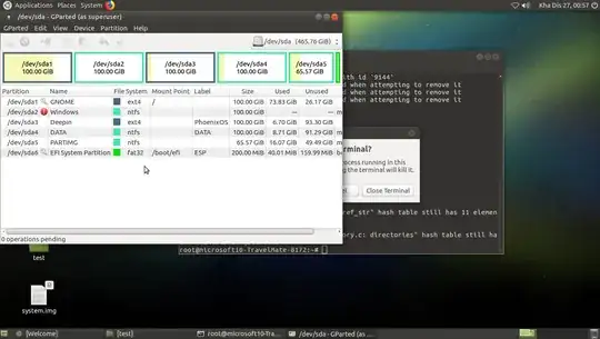

Laptop HDD
https://i.sstatic.net/yDRC2.png
sda1: Ubuntu MATE 16.04
sda2: Windows 10
sda3: Phoenix OS
sda4: DATA (Backup Storage Partition)
sda5: PARTIMG (Partition Image Storage)
sda6: ESP (EFI System Partition)

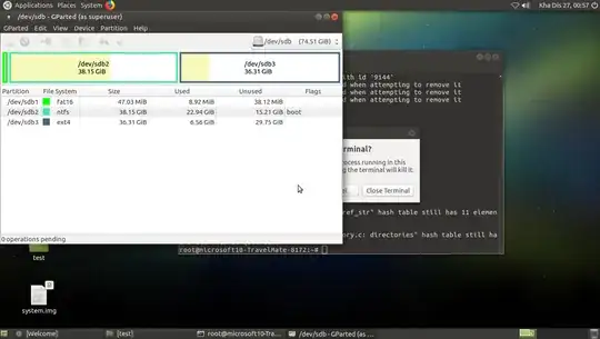

Desktop HDD
https://i.sstatic.net/ZMKIW.png
sdb1: Dell System Utility (OEM Partition)
sdb2: Windows XP SP3 Home Edition
sdb3: Ubuntu XFce 18.04
