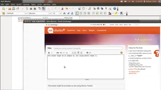

The answer might be as simple no, but using Ubuntu Tweak I made the borders of my windows transparent as shown here: enter image description here
However, the window buttons and window title are also transparent, making them look out of place. Can I make the close, minimise, and maximise buttons as well as the window title non-transparent?

This would be possible with Emerald (which is no longer maintained), but it is not possible with metacity/gnome-window-decorator/unity-window-decorator.
You can file a wishlist bug though.
