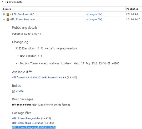

Here's a screenshot to better show the location of the download link:
Source of image: https://launchpad.net/~hanipouspilot/+archive/ubuntu/rtlwifi/+packages?field.name_filter=&field.status_filter=published&field.series_filter=xenial
deb highlighted in blue
