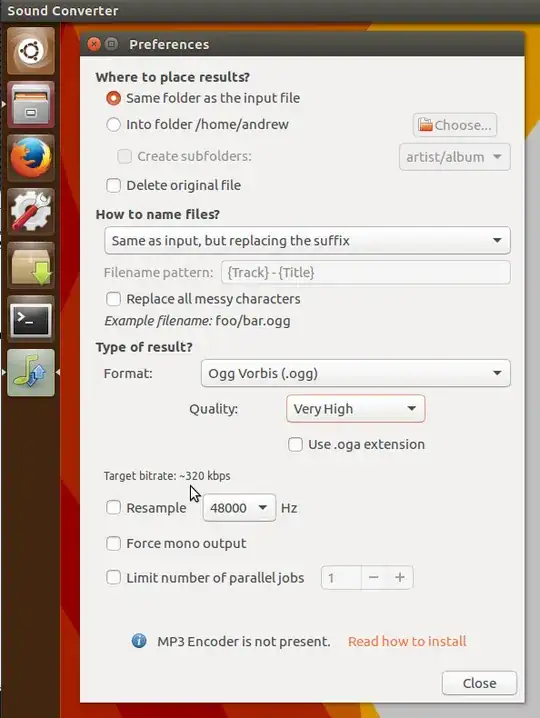

The results can be seen in this screenshot, note the 320kbps setting indicated with the mouse pointer:
This leaves you with the following bitrates available from within Soundconverter:
