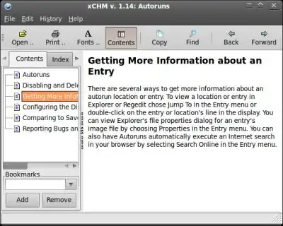

xChm Viewer
Install the xChm Viewer for viewing CHM files:
sudo apt-get install xchm

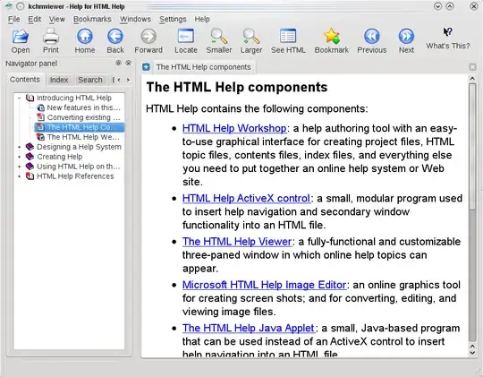

kchmViewer Install kchmviewer
The main advantage of kchmviewer is the best support for non-English languages. Unlike other viewers, kchmviewer in most cases is able to correctly detect the chm file encoding and show it. It correctly shows the index and table of context in Russian, Spanish, Romanian, Korean, Chinese and Arabic help files, and with new search engine is able to search in any chm file no matter what language it is written.
kchmviewer
