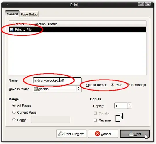

  3. You can now open up the HTML file with Firefox and select Print, which will allow you to print it to a file, outputting a PDF. Go to "Options" to get rid the margin notes that firefox will put into the output.
    alt text
