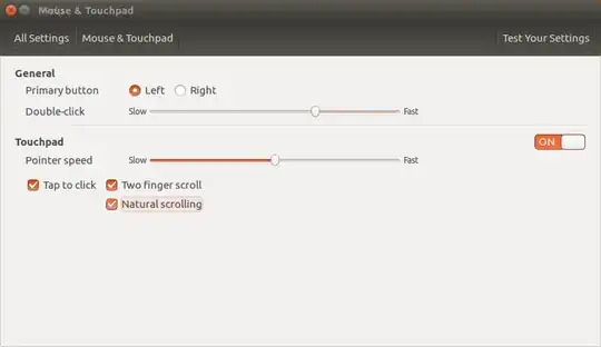

The option to invert scrolling directions is called Natural Scrolling and is still present in 16.04's System Settings → Mouse & Touchpad configuration.
