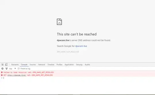

I try to create virtual host on ubuntu server, but I get the message like image.

First of all you must register dpacam.live. It is not registered yet! After that, you must connect [redirect] the domain (dpacam.live) with [to] your static IP address. You can do that through the administrative panel of your DNS provider. About next steps please check my answer here.
Edit: I remember that I have two comments related to the current question:
