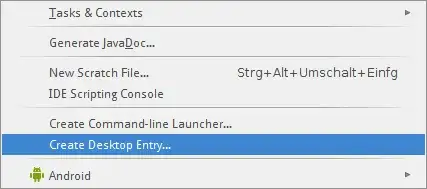

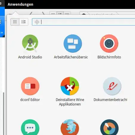

Android Studio -> Tools -> Create Desktop Entry
Now, you should be able to see in your system menu:

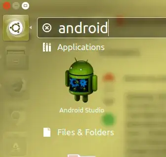

Alternatively, you can also open Android Studio, click on Configure -> Create Desktop Entry. This should create an entry on the dash:
screenshoot

You can open Android Studio, click on Configure -> Create Desktop Entry. This should create an entry on the dash.
11
From the quick start panel, (which opens up once android-studio IDE launched), click on "Configure" which takes you to the configure panel then click on "Create Desktop Entry".
You can also go to Tools -> Create Desktop Entry once you're inside an Android Studio Project.
