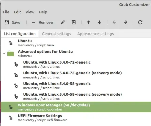

Use grub-customizer: https://launchpad.net/grub-customizer
sudo add-apt-repository ppa:danielrichter2007/grub-customizer
sudo apt-get update
sudo apt-get install grub-customizer
This is a GUI that will allow you to hide unwanted grub entries.
This is how the grub-customizer looks like enter image description here

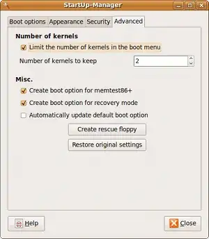

Depending on your grub version, you could use the StartUpManager application to maintain your grub menu. Its Advanced Tab settings allow selecting / deselecting a Memtest / Recovery boot entry and also the number of kernel versions. With grub2, "the Appearance and Advanced tabs contain fewer entries at present, and the Security tab does not exist with Grub 2 fully-installed." (see here, "Grub 2 Note").
