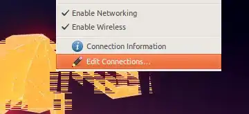

First, go to the networking indicator and select "Edit connection" to configure a new connection:
Click 'add' and choose a name for the spoofed MAC network connection.

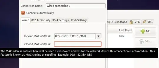

After selecting your interface "eth0" in the top dropdown, you can simply choose any MAC address you like:
And after connecting to it, you'll be using your new MAC address.
Running ip link ls will show you the new interface, including it's spoofed MAC:
