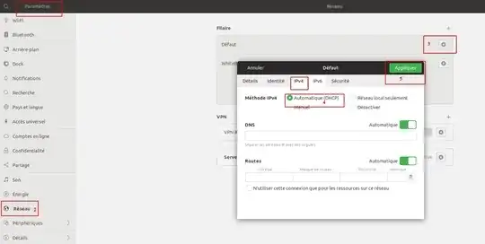

I start from the principle that your computer is connect to your home LAN network with an ISP Box. You don't have any IP address on your Ethernet interface but the interface link seems to be up.
  1. Please run the command sudo dhclient -v enp0s31f6 in a terminal (this command will try to get an IP address from a DHCP server: your box).
  2. Then check if you receive an IP address (command ip address or ifconfig). If you doesn't get an address, please copy & paste the output of the command dhclient.
  3. If you correctly get an IP, then test your internet connectivity:
    ping 8.8.8.8 -I enp0s31f6
    8.8.8.8 is the address of Google’s DNS.
  4. If your not able to ping this address, then check the routes with the command ip route. Ensure that the IP of your box is the default gateway of your computer.
    Please check the configuration of the network manager. Go to Parameters → Network → Default → click on the gearwheel → IPv4, select Automatic (DHCP) and apply the change.
    IPv4 network configuration dialogue
