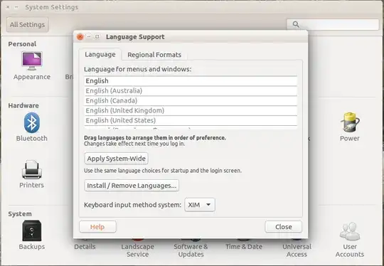

  2. Set the input method "XIM" from the Language Support tool instead:
    Keyboard input method system: XIM
  3. Remove (or move) your ~/.config/dconf/user file (here's some info on what dconf is).
  4. Log out and log in again.
Thanks to Gunnar Hjalmarsson for pointing the bug #1573755 out. If this solutions doesn't work for you, you might find something useful in the thread.
