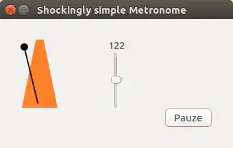

2. Shockingly simple GUI version
As a next step, a very basic version, the last version without an installer:
The script

The image
How to use
  1. Like the cli version, this one needs vorbis-tools:
    sudo apt-get install vorbis-tools
  2. Copy the script into an empty file, save it as metro.py
  3. Right- click on the image above, save it In one and the same directory as the script (exactly) as: icon.png.
  4. Simply run the metronome by the command:
    python3 /path/to/metro.py

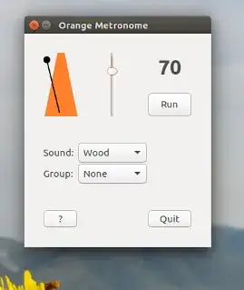

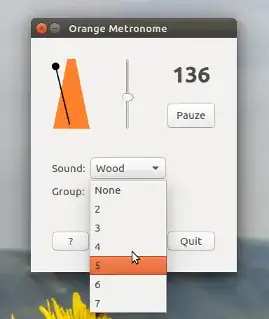

3. PPA for the Orange Metronome
It is done!
The metronome is ready for installation.
The Orange Metronome comes with a set of different sounds to choose from, and the beats can be grouped. All changes are applied immediately on the running metronome:
To install:
sudo apt-add-repository ppa:vlijm/orangemetronome
sudo apt-get update
sudo apt-get install orangemetronome

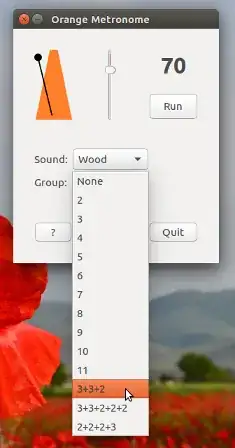

Work to do
  • Currently, the metronome comes with four different sounds to choose from. Probably a few will be added in the next few days, some of them will be replaced/updated
  • On the longer term
    For the longer term, I am thinking of adding the option for (custom) complex structures like 3+3+2, 2+2+2+3 etc., which I always missed in existing metronomes.
Finally
The latest (current) version 0.5.3 adds a number of sounds, but more importantly, the option to run irregular (composite) beats. In this version, they are hard coded. Will be customizable from version > 1.
