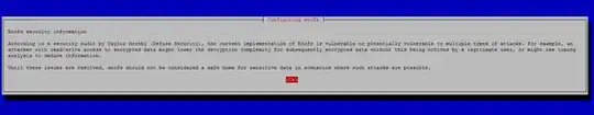

I love encfs as it provides file-based encrypting which is quite useful when it comes to cloud storage. But it looks like that especially for this use case, encfs is considered to be insecure. I'm aware that encfs 2 is in development but how to deal with it in the meantime? Are there any alternatives that integrate well in ubuntu?
Edit: The security issue I mostly refer to is this one. It is still present in version 1.8 and makes your files vulnerable if someone get's multiple versions of your encrypted files. If one is worried about services like Dropbox are not that thrustworthy and encrypts folders uploaded into the cloud because of that, the opportunity that the attacker (the service) gets more than one copy of the cyphertext is absolutely given.
