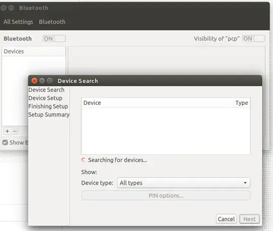

I am using Ubuntu 16.04 Lts on my Sony Vaio.
I want to connect to my Bluetooth Headphone?
Graphical UI keeps on serching but never finds any bluethooh devices.

What is probably wrong with bluethooth device?
