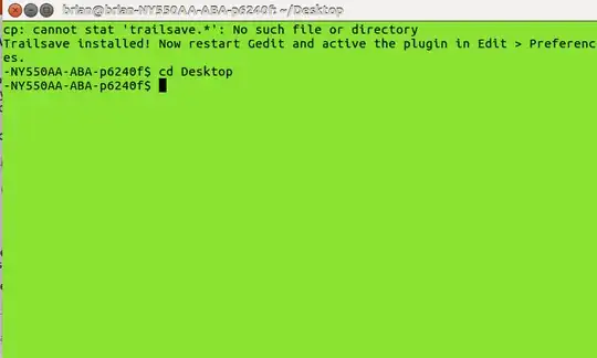

I don't know what I did, but somehow I made it so that when I change directories it shows up on the very top of the Terminal. Here is a screenshot of what I am talking about:
I am happy it's still working, probably a setting issue somehow. How do you change it so that when you change directories the information is found inside the terminal, not on top?

I assume you want the current working directory to show in your prompt.
According to your screenshot, your prompt is showing only your machine name. The output you gave for echo $PS1 doesn't even give me that... I can't replicate your prompt without a bit of tinkering: maybe you have: \[\e]0;\u@\h: \w\a\]\H\$ or... you're using a different shell maybe??

So maybe you put something in your .bashrc to override that. Have a look at the end of it for lines like
export PS1="some code here"
or
export PS1
To see if it has been overridden, and comment out those lines if they are there (put # at the start of the line) or just remove them.
You can also check that the section I pasted above (line 38-73 in my .bashrc) exists and hasn't been changed, if you just want to restore the normal prompt.
