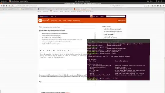

Since I upgraded1 from Ubuntu 15.04 to 15.10, I stumbled upon a really frustrating bug of gnome: if I click on a window, it correctly gets the focus but stays in the background (see screenshot below).
Please note that this issue is not related to any particular window or application. It's the whole window manager that screws up!
Screen capture of the strange behaviour
Here, I clicked on the firefox' window, it get the focus --- I can enter keyboard shortcuts for instance --- but the gnome-terminal window sits there ...
If I Alt-Tab, the newly focused window is correctly put in the front.
