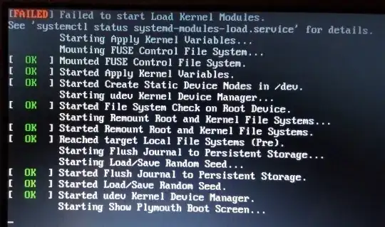

Yesterday I was booting up my computer and it gave me this error message:

EDIT: journalctl | grep modules gives me:
 systemd-modules-load[214]: Inserted module 'lp'
 systemd-modules-load[214]: Inserted module 'ppdev'
 systemd-modules-load[214]: Inserted module 'parport_pc'
 systemd-modules-load[214]: Failed to find module 'rtc'
 systemd[1]: systemd-modules-load.service: Main process exited, code=exited, status1/FAILURE
 systemd[1]: systemd-modules-load.service: Unit entered failed state
 systemd[1]: systemd-modules-load.service: Failed with result 'exit-code'

OP solved their problem as follows:
[FAILED] Failed to start Load Kernel Modules was a red-herring. rtc is an obsolete module. The error message was removed by switching to tty1 (ctrl+alt+F1) and commenting out rtc (putting # at the start of the line) in /etc/modules (using sudoedit).
Now the computer would just boot to a blank screen.
